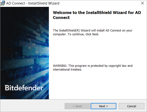

Double click on the file to begin the installation.
Click the Next button to continue.

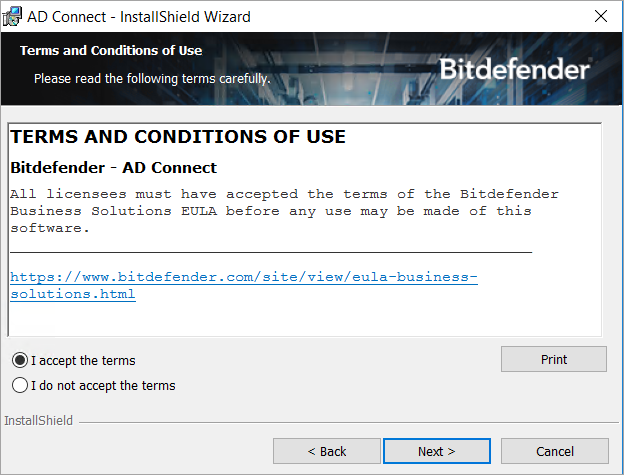

Read the terms and conditions, select I accept the terms and click on the Next button.

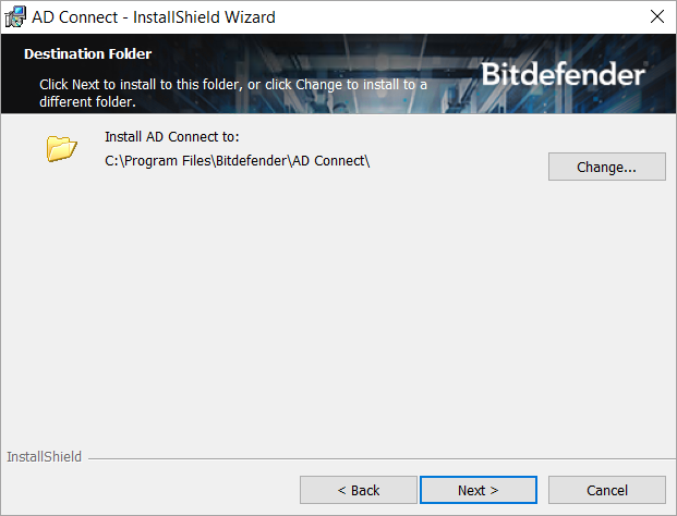

(optional) Change the installation path by clicking on the Change... button and selecting a different folder.
Click on the Next button to continue.

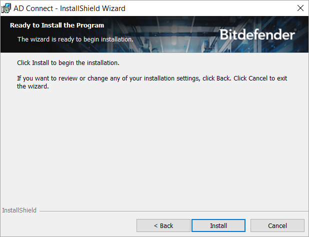

Click the Install button to begin the installation.

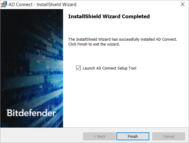

Click the Finish button to complete the installation.
Checking the Launch AD Connect Setup Tool box will begin the setup process.
if successfully installed, AD Connect will run as a background Windows Process.

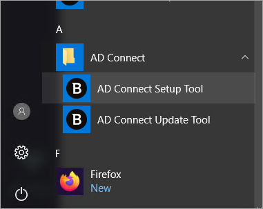

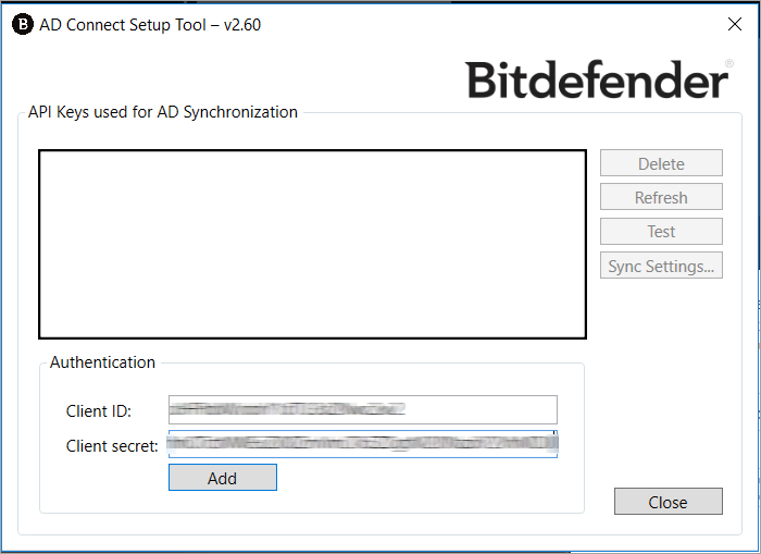

Launch the AD Connect Setup Tool. You can do this by finding the launcher in the Windows Start menu:
Get the required Client ID and Client Secret from your GravityZone Security for Email console.
For instructions on getting this information refer to this kb article.
Add this information in the AD Connect Setup Tool
Click the Add button.
A window will appear confirming that the authentication was successful.
Launch the the AD Connect Update Tool. You can do this by finding the launcher in the Windows Start menu:
The tool will search online for an available update and launch the installer if one is found.
