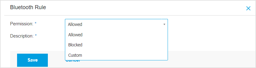

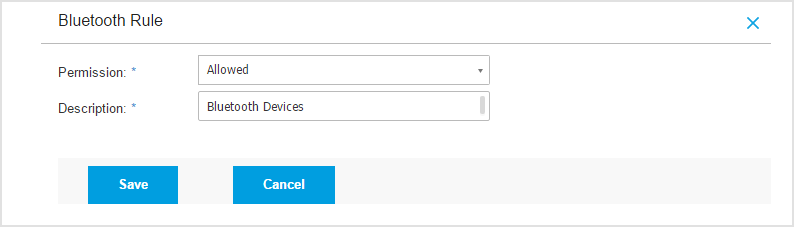

Configure Rules

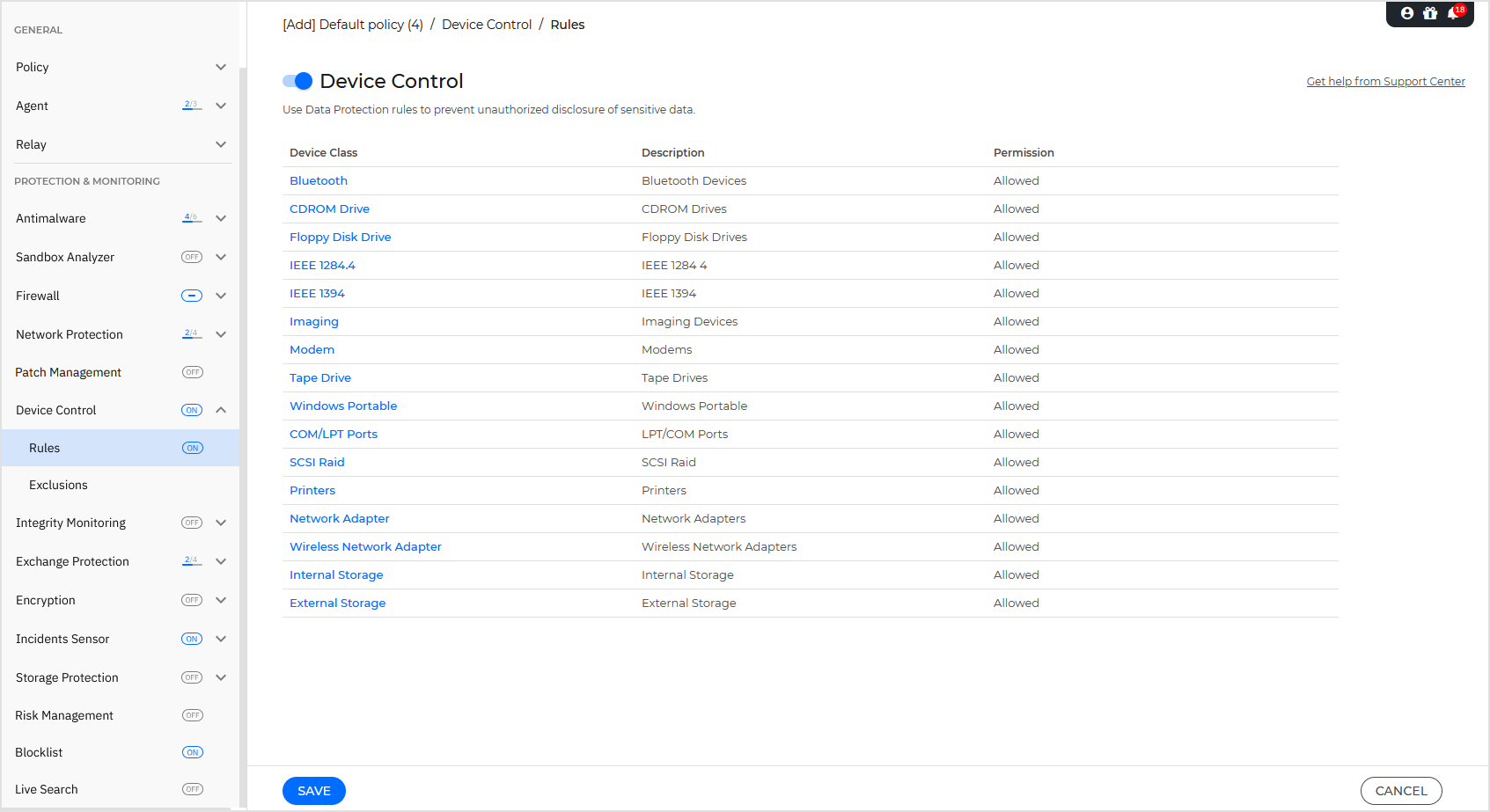

Once Device Control is enabled, you can set up rules that determine whether a type of devices is allowed on your network or not. Follow these steps to set up rules:
Select the type of device you want to set up from the Device Classes grid.
Select the permission from the drop-down list. You can choose between Allowed, Blocked, or Custom.
If you have selected the Custom option, you can set up permissions for a variety of sub-classes. For each sub-class, choose from the drop-down list between Allowed and Blocked.
Click Save.

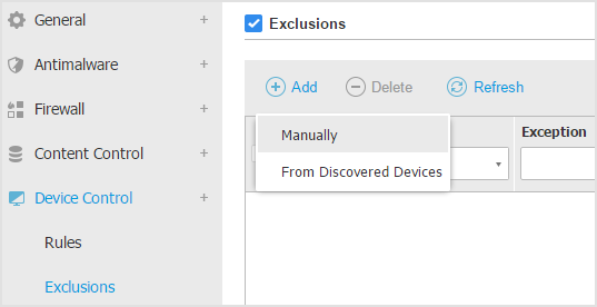

Create Exclusions
Access the Exclusions section to add exceptions for devices available in your network . By adding exclusiond you allow certain devices to become accesible in your network.

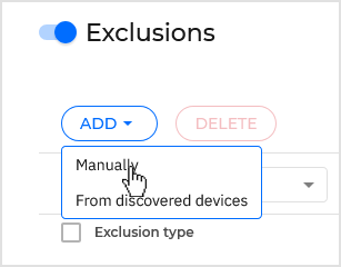

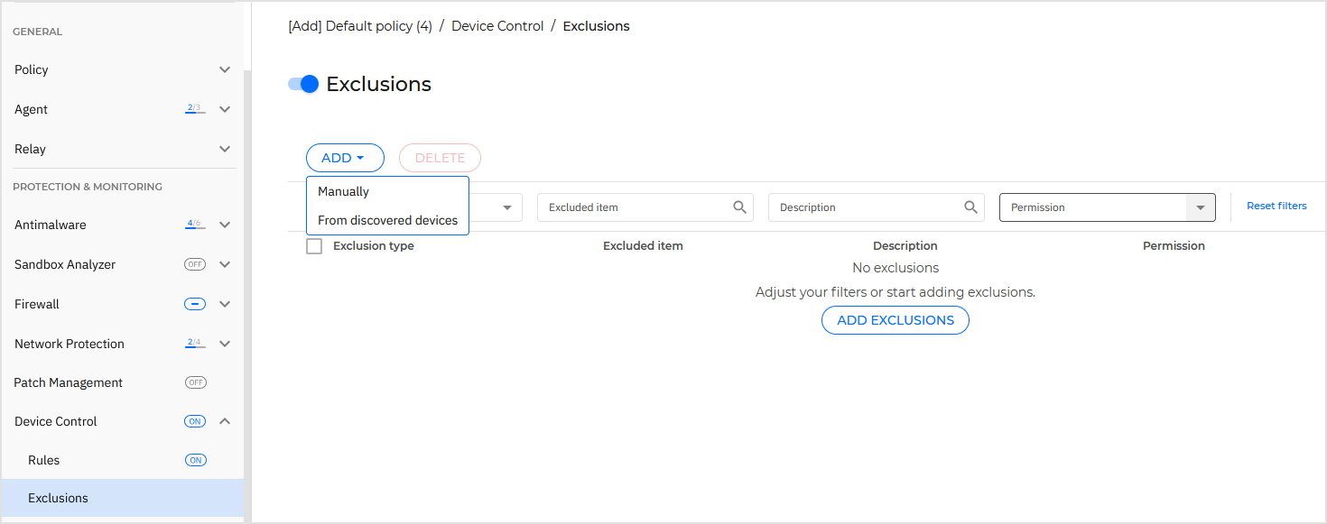

To start adding exclusions click the Add button and select from the drop-down the way in which you want to start adding the exclusions.
![Use-device-control-in-gravityzone-create-exclusions.png](image/uuid-829f8ce7-461b-43fd-28a3-7461f2096812.png)

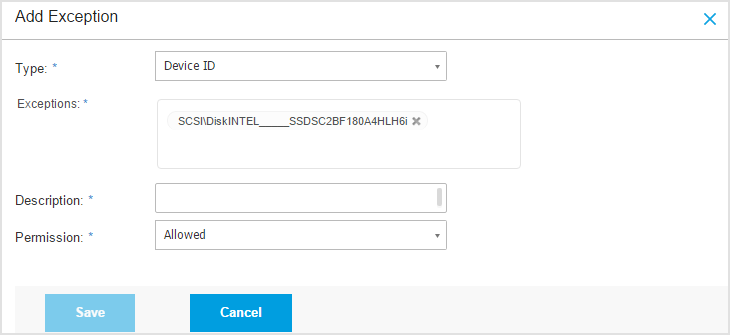

Select Manually to open the Add Exception window.

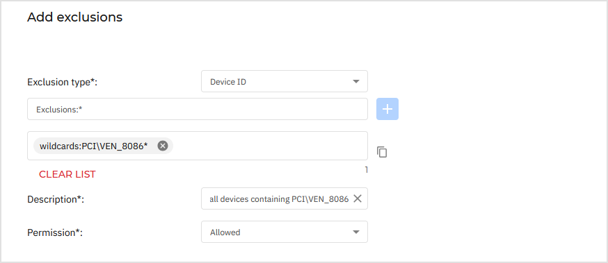

Select the type of exception, Device ID or Product ID.
Optionally, you can configure wildcard exclusions based on Device ID by using the
wildcards:deviceID
syntax.Use the question mark
to replace one character, and the asterisk (*
) to replace any number of characters in thedeviceID
.For example, for
wildcards:PCI\VEN_8086*
, all devices containing the stringPCI\VEN_8086
in their ID will be excluded from the policy rule.Click Save.

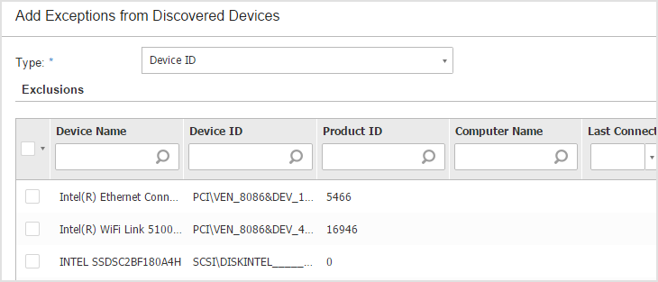

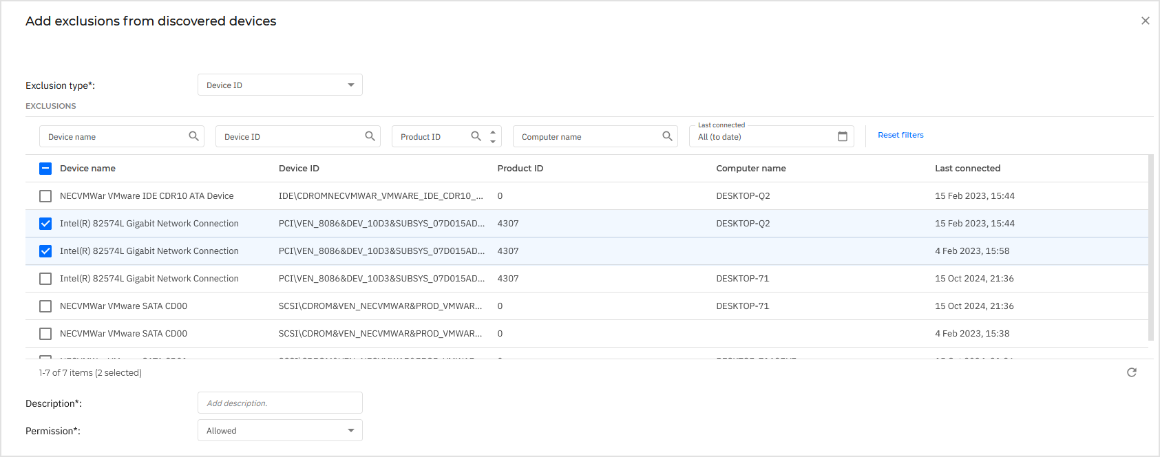

Select Add Exception from Discovered Devices from the drop-down list. This window displays all devices from endpoints with Device Control enabled.
Select the devices you want to exclude.
Click Save
