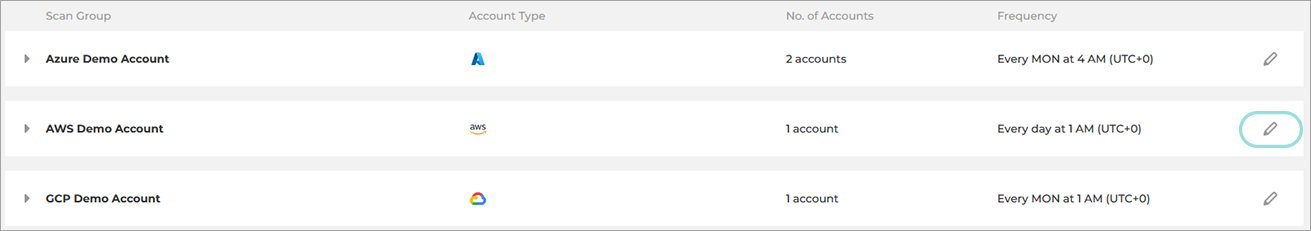

To edit a scan group, follow these steps:
Click the Edit button on the right side of the scan group you want to edit.

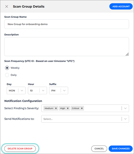

The Scan Group Details page is displayed.
Make the modifications you need to the following sections:
Scan Group Name - the name of the scan group. You can use the group name to easily identify and search for the group in the GravityZone Cloud Security Posture Management console.
Description - the description of the scan group. This information makes it easier for you to identify the purpose of the group and what cloud accounts are linked to it.
Scan Frequency - determine the frequency of automatic scans that run on the accounts in the group:
Daily - a scan will run daily, at the time you select.
Weekly - a scan will run once per week, at the time and day you select.
Notification Configuration - configure when notifications are sent and who receives them using these settings:
Select Finding's Severity - notifications will only be send for findings of the selected severity.
Send notifications to - notifications will only be be sent to the selected Slack channels.
Tip
This feature requires an integration with Slack.
Click the Save changes button on the lower right side of the window.

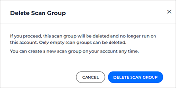

To delete a scan group, follow these steps:
Click Delete scan group.
This button is only available if no cloud accounts are linked to the scan group.
A confirmation window is displayed.
Click Delete scan group to confirm the request.

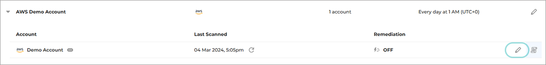

To edit a specific cloud account follow the steps below:
Click the name of the scan group to expand the item and display the list of accounts associated to it.
Click the Edit button on the right side of the account you want to edit.
