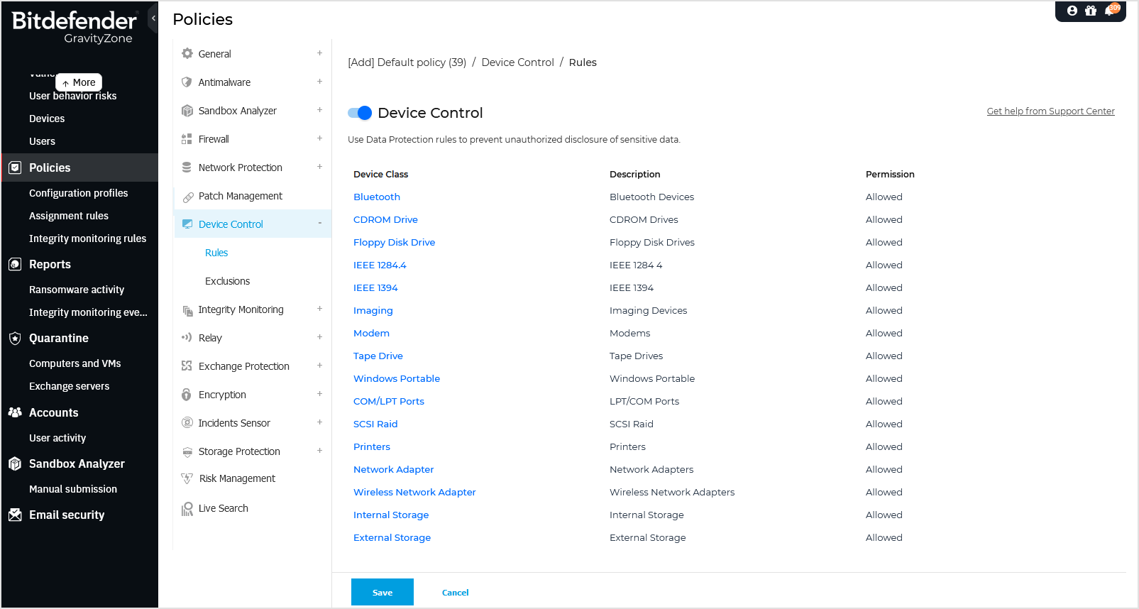

The Device Control > Rules section in the policy allows you to define the permissions for devices connected to the target endpoints.
To set permissions for the type of device that you want:
Go to Device Control > Rules and click the toggle to enable a permission category for the selected device type.
Once enabled, you must configure the access rules accordingly. Enabling the toggle alone does not apply any restrictions. You need to define what is allowed or blocked under each permission to enforce proper control.
Click the device name in the available table.
Select one permission type from the available options. The available set of permissions may vary according to the device type:
Allowed: the device can be used on the target endpoint.
Blocked: the device cannot be used on the target endpoint. In this case, each time the device is connected to the endpoint, the security agent will prompt a notification stating that the device has been blocked.

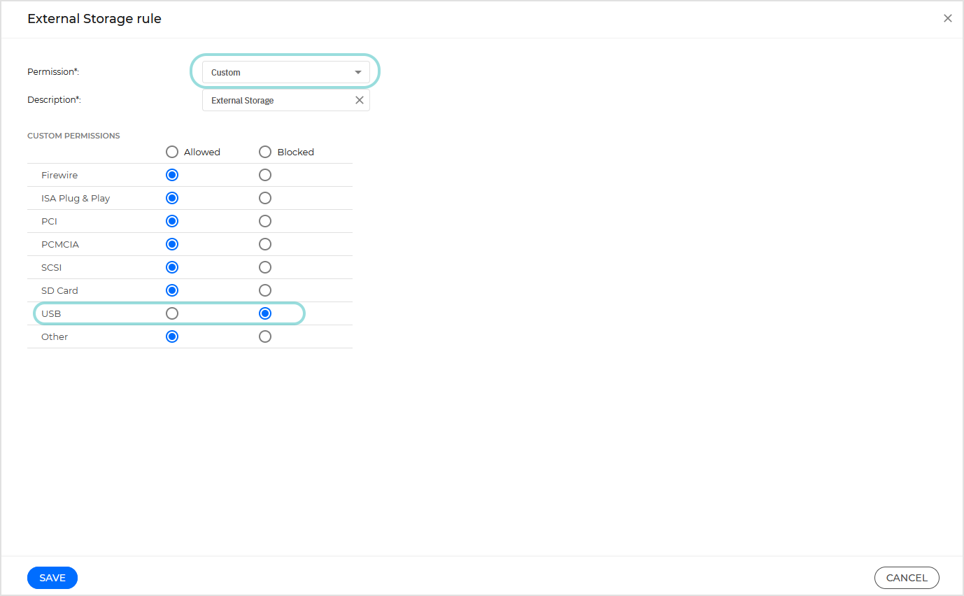

Custom: define different permissions for each type of port from the same device, such as Firewire, ISA Plug & Play, PCI, PCMCIA, USB, etc. In this case, the list of components available for the selected device is displayed, and you can set the permissions that you want for each component.
For example, for External Storage, you can block only USB, and allow all the other ports to be used.

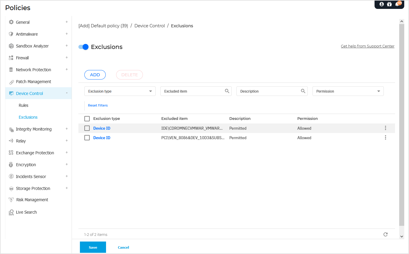

After setting the permission rules for different types of devices, you may want to exclude certain devices or product types from these rules.
You can define device exclusions:
By Device ID (or Hardware ID), to designate individual devices that you want to exclude.
By Product ID (or PID), to designate a range of devices produced by the same manufacturer.
To define device rule exclusions:
Go to Device Control > Exclusions.
Enable the Exclusions option.
Click the Add button at the upper side of the table.
Select the method you want to use for adding exclusions:
Manually - In this case, you need to enter each Device ID or Product ID that you want to exclude, provided you have at hand the list of appropriate IDs:
Select the exclusion type (by Product ID or by Device ID).
In the Exclusions field, enter the IDs that you want to exclude.
Quotation marks are not required when entering the exclusion path.
In the Description field, enter a name that will help you identify the device or the range of devices.
Select the permission type for specified devices (Allowed or Blocked).
Click Add exclusions.

From discovered devices - In this case, you can select the Devices IDs or Product IDs to exclude from a list of all discovered devices in your network (concerning the managed endpoints only):
In the Exclusions table, select the IDs that you want to exclude:
For Device IDs, select each device to exclude from the list.
For Product IDs, by selecting one device, you will exclude all the devices having the same Product ID.
Important
Devices already connected to endpoints at the Bitdefender Endpoint Security Tools installation will be discovered only after restarting the corresponding endpoints.
Connected devices previously blocked are not automatically unblocked by setting an exception with the permission Allowed. The user must restart the system or reconnect the device to be able to use it.
All device exclusions will appear in the Exclusions table.

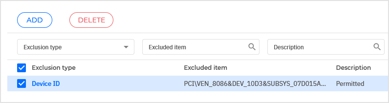

You can delete one or several rules at once. Once a rule is deleted, you cannot recover it.
To remove a single exclusion:
In the table, go to the desired rule.
Click to open the
More menu.
Click the Delete option.
To delete multiple exclusions at once:
Select the exclusions in the table.
Click the Delete button at the upper side of the table.
