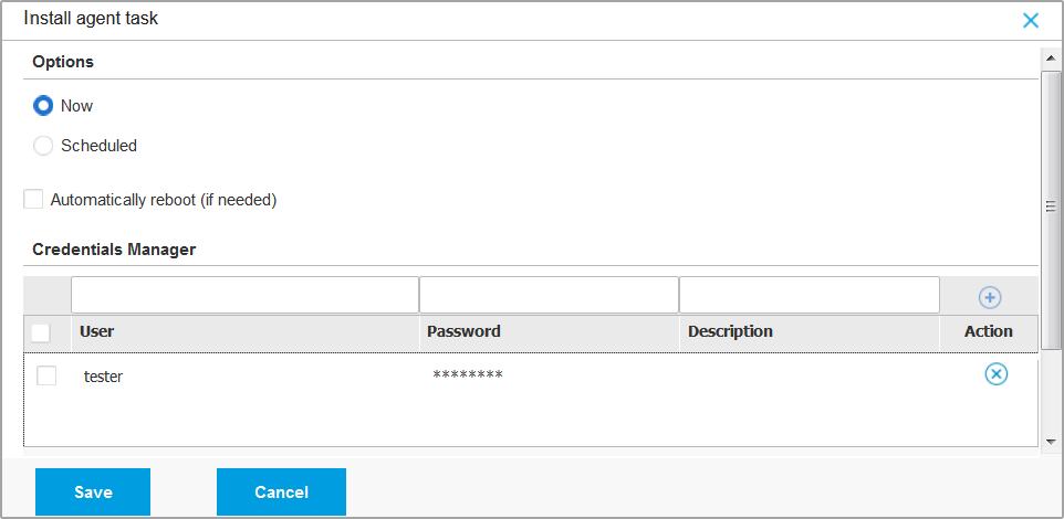

During execution, the Install agent task follows these steps:
  1. Configure task - Read policy settings and configure the task.
  2. Resolve hostnames to IP addresses - Convert hostnames to IP addresses for efficient network communication.
  3. Determine target OS - Identify each target’s operating system to ensure compatibility with the required installation package.
  4. Validate deployment targets - Verify that each target has the necessary attributes (for example: IP address, OS details). Targets missing mandatory data are excluded.
  5. Initiate parallel task execution - Start a dedicated execution thread for each valid target to allow concurrent deployment.
  6. Execute pre-tasks - Perform preliminary setup steps per target, such as synchronizing the deployment kit.
  7. Download deployment kit - Retrieve the required installation package for each target.
  8. Deploy software - Transfer installation files to the remote host, configure them, and execute the deployment.
Since deployment is time-consuming, the task must continuously report its current state to the GravityZone console to keep the network administrator informed.

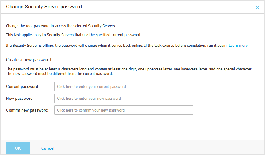

To change the Security Server password, follow these steps:
  2. Go to the Network page from the left side menu.
  3. Choose Computers and Virtual Machines from the views selector.
  4. Select the group where the Security Server is installed.
    To easily locate the Security Server, you can use the Filters menu as follows:
    • Go to Security tab and select Security Servers only.
    • Go to Depth tab and select All items recursively.
  5. Click the task.png Tasks button at the upper side of the table and choose Change Security Server password.
  6. On the configuration page:
    1. Enter your current Security Server password.
      The default password at the installation time is sve.
      If you forgot the password, you can reset it. For details, refer to Reset root password for Security Server.
    2. Enter your new password.
      The password must be at least 8 characters long and contain at least one digit, one uppercase letter, one lowercase letter, and one special character.
    3. Confirm the new password.
      The default password expiration period is 90 days. You can extend this duration or disable password expiration in the Configuration > Security Server settings section in GravityZone Control Center.
  7. Click OK to create the task.
    This task applies only to Security Servers that use the specified current password. To update other Security Servers with different passwords, run the task again for those instances.
    If a Security Server is offline, the password will change when it comes back online. If the task expires before completion, run it again.

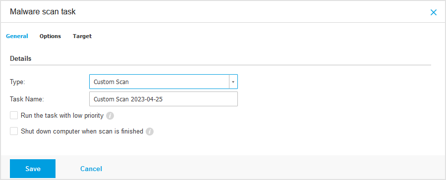

Malware scan
To remotely run a scan task on one or several virtual machines:
  3. Choose Virtual Machines from the views selector.
  4. Select the container that you want from the left-side pane.
    All the entities contained in the selected group are displayed in the right-side pane table.
  5. Select the check boxes corresponding to the objects you want to scan.
  6. Click the task.png Tasks button at the upper side of the table and choose Malware scan. A configuration window will appear.
  7. Configure the scan options:
    1. Go to the Options tab to set the scan options.
    2. Click the security level that best suits your needs (Aggressive, Normal or Permissive).
    3. Use the description on the right-side of the scale to guide your choice.
    Based on the selected profile, the scan options in the Settings section are automatically configured. However, if you want to, you can configure them in detail. To do that, select the Custom option and then expand the Settings section.

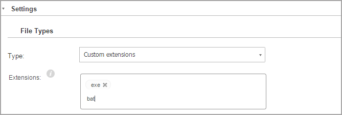

      If you want only specific extensions to be scanned, choose Custom extensions from the menu and then enter the extensions in the edit field, pressing Enter after each extension.
      Bitdefender security agents installed on Windows and Linux operating systems scan most of the .ISO formats, but does not take any action on them.

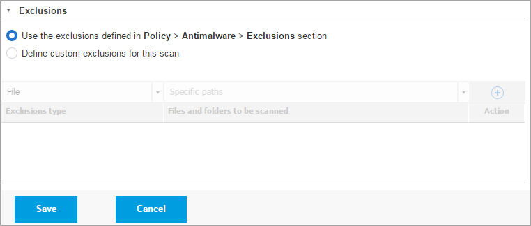

      Click the Exclusions section if you want to define target exclusions.
      You can either use the exclusions defined by policy or define explicit exclusions for the current scan task.
      For more details regarding exclusions, refer to Exclusions .

    • Options. Configure the scan options for emails matching the rule:
      • Scanned file types. Use this option to specify which file types you want to be scanned. You can choose to scan all files (regardless of their file extension), application files only, or specific file extensions you consider to be dangerous. Scanning all files provides the best protection, while scanning only applications is recommended for a quicker scan.
        Application files are far more vulnerable to malware attacks than other types of files. For more information, refer to Application file types.
        If you want to scan only files with specific extensions, you have two alternatives:
        • User defined extensions, where you must provide only the extensions to be scanned.
        • All files, except specific extensions, where you must enter only the extensions to be skipped from scanning.

  7. Under Options section, configure the installation time:
    • Now, to launch the deployment immediately.
    • Scheduled, to set up the deployment recurrence interval. In this case, select the time interval that you want (hourly, daily or weekly) and configure it according to your needs.
      For example, when certain operations are required on the target machine before installing the client (such as uninstalling other software and restarting the OS), you can schedule the deployment task to run every 2 hours. The task will start on each target machine every 2 hours until the deployment is successful.
  8. If you want target endpoints to automatically restart for completing the installation, select Automatically reboot (if needed).
  9. Under the Credentials Manager section, specify the administrative credentials required for remote authentication on target endpoints. You can add the credentials by entering the user and password for each target operating system.
    Important
    For Windows 8.1 stations, you need to provide the credentials of the built-in administrator account or a domain administrator account. To learn more, refer to Client software deployment on Windows 8.1/10/2012 and above.Client software deployment on Windows 8.1/10/2012 and above
    A warning message is displayed as long as you have not selected any credentials. This step is mandatory to remotely install Bitdefender Endpoint Security Tools on endpoints.
    To add the required OS credentials:
    1. Enter the user name and password of an administrator account for each target operating system in the corresponding fields from the credentials table header. Optionally, you can add a description that will help you identify each account more easily.
      If the machines are in a domain, it suffices to enter the credentials of the domain administrator.
      Use Windows conventions when entering the name of a user account:
      • For Active Directory machines use these syntaxes: username@domain.com and domain\username. To make sure that entered credentials will work, add them in both forms (username@domain.com and domain\username).
      • For Workgroup machines, it suffices to enter only the user name, without the workgroup name.
    2. Click the add_inline.png Add button.
      The account is added to the list of credentials.
      Specified credentials are automatically saved to your Credentials Manager so that you do not have to enter them the next time. To access the Credentials Manager, click the control_center_user_menu_icon.png user icon in the upper-right corner of the console.
      Important
      If the provided credentials are invalid, the client deployment will fail on the corresponding endpoints. Make sure to update the entered OS credentials in the Credentials Manager when these are changed on the target endpoints.
    3. Select the check boxes corresponding to the accounts you want to use.

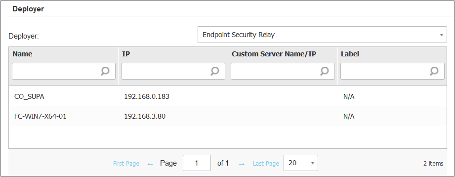

  10. Under Deployer section, choose the entity to which the target machines will connect for installing and updating the client:
    • GravityZone Appliance, when the machines connect directly to GravityZone Appliance.
      For this case, you can also define a custom communication server appliance by entering its IP or hostname, if required.
    • Endpoint Security Relay, if you want to connect the machines to a Relay client installed in your network. All machines with Relay role detected in your network will show-up in the table displayed below. Select the Relay machine that you want. Connected endpoints will communicate with Control Center only via the specified Relay.
      Important
      • Port 7074 must be open, for the deployment through the Relay agent to work.
      • When deploying the agent through a Linux Relay, the following conditions must be met:
        • The Relay endpoint must have installed the Samba package (smbclient) version 4.1.0 or above and the net binary/command to deploy Windows agents.
          The net binary/command is usually delivered with the samba-client and / or samba-common packages. On some Linux distributions (such as CentOS 7.4), the net command is only being installed when installing the full Samba suite (Common + Client + Server). Make sure that your Relay endpoint has the net command available.
        • Target Windows endpoints must have Administrative Share and Network Share enabled.
        • Target Linux and Mac endpoints must have SSH enabled and firewall disabled.

  14. You have to set an administrative password for the Security Server console. Setting an administrative password overrides the default root password ("sve").
    The administrative password must contain at least 8 characters, one digit, at least one upper case character, at least one lower case character, one special character and must be changed every 3 months.
