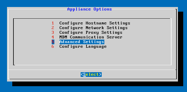

The GravityZone appliance comes with a basic configuration interface, available from the management tool used for managing the virtualized environment where you have deployed the appliance.
These are the available main options after the first GravityZone appliance deployment:
Use the arrow keys and the Tab
key to navigate through menus and options. Press Enter
to select a specific option.

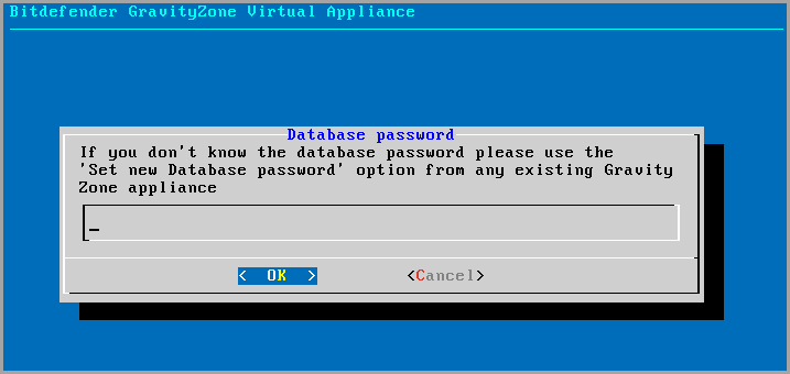

again. Configure the database password and then wait for the installation to complete.If you have already deployed another appliance with the Database Server role, choose Cancel and return to the Add or remove roles menu.
You must then choose Configure Database Address and enter the address of the database server.
Make sure you set a database password before accessing this option. If you don't know the database password, configure a new one by selecting Advanced Settings > Set a new database password from the main menu.

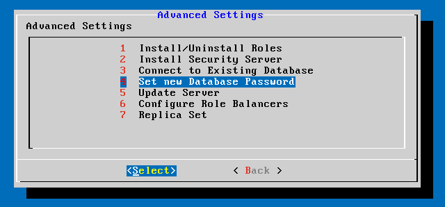

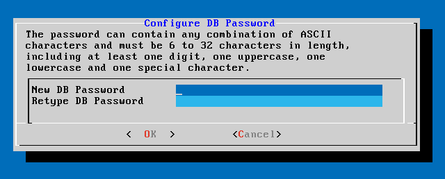

Set new database password
When installing the Database Server role, you are required to set up a password to protect the database. In case you want to change it, set a new one by accessing Advanced Settings > Set a new database password from the main menu.
![cli-set-new-db-pass.png](image/uuid-dc7c6edd-5ca2-22ab-070b-a78ac2cdb443.png)
Follow the guidelines to set up a strong password.

Access the appliance console from your virtualization management tool (for example, vSphere Client).
From the main menu, select Advanced Settings.
Select Enable Secure VPN Cluster.

Select Connect to Existing Database.
Make sure you set a database password before accessing this option. If you don't know the database password, set a new one by accesing Advanced Settings > Set a new database password from the main menu.

Change the MongoDB password
When first installing the database role in the initial setup of the GravityZone appliance, you will be prompted to setup a MongoDB password.
![26264_1.png](image/uuid-808328ac-e333-3d2d-bb09-d5c3afb81b1f.png)
If the MongoDB is already installed, we recommend changing the password as restricting access to critical servers like Bitdefender GravityZone Database is a best practice for preventing attacks.
To change the database password, follow these steps:
Log in to the appliance CLI, using the bdadmin credentials set;
Go to Advanced Settings;
Go to Set new Database Password;
Follow the password requirements in order to setup the new password (must be between 6 and 32 characters in length, including at least one uppercase, one lowercase, one digit and one special character);
Press OK.

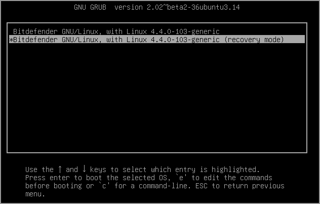

Press any key to interrupt the boot sequence. During the boot sequence, the GRUB boot loader appears on your screen.
Use the arrow keys to select Advanced options for Bitdefender GNU/Linux and press Enter.
In the following screen, select Bitdefender GNU/Linux, with version x.x.x-xxx-generic (recovery mode). GravityZone OS boots into Recovery Mode.

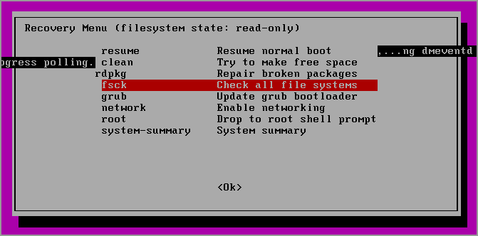

In the Recovery Menu, select fsck and press Enter. A confirmation dialog prompts you to validate your operation.
After the filesystem check is done, you can see the finished output. Press ENTER to get return to Recovery Mode.
Select resume to continue the normal boot sequence.

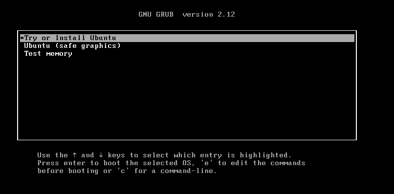

Boot the GravityZone VA from the Ubuntu image and select Try Ubuntu when prompted. Ubuntu boots up.

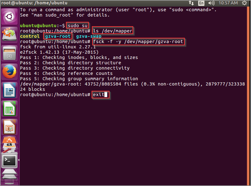

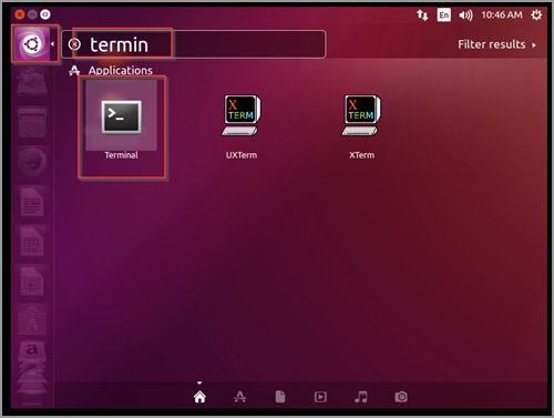

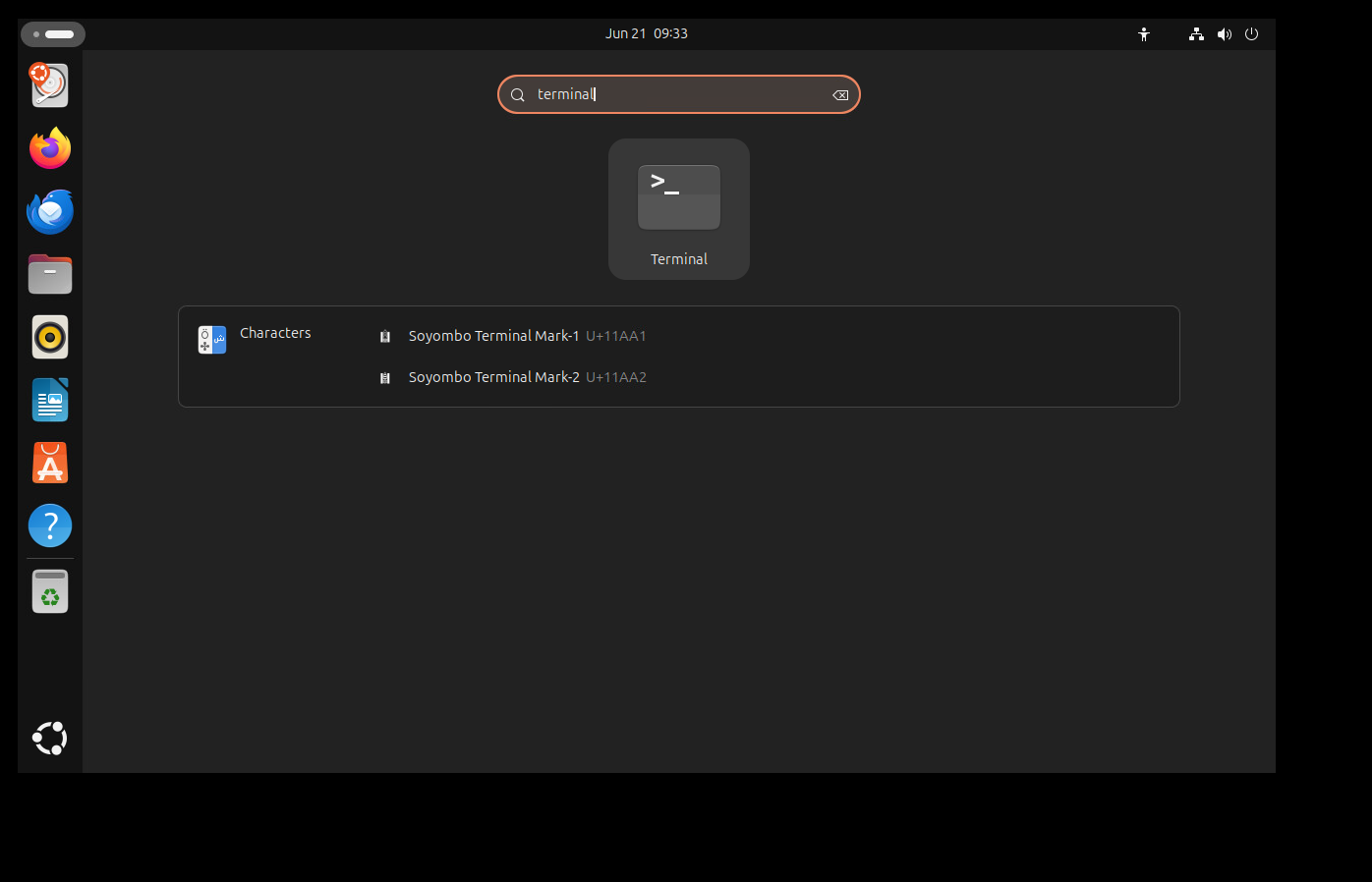

In Ubuntu desktop, click the search bar at the top of the screen and start typing terminal.

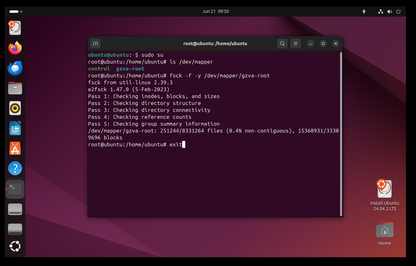

Open Terminal and run the following commands:
sudo su
ls /dev/mapper
Identify the system disk of the GravityZone VA. You can look for the following names: gzva-root, gzva-data, gz-data or gz-root.
Run the following command to perform a filesystem check:
fsck –f -y /dev/mapper/gzva-root
In this example we used gzva-root, as seen in the screenshot below.If there are any errors during this operation, you will be prompted by confirmation dialogs. Select yes to all fsck questions.
After the filesystem check is done, reboot the GravityZone VA without the Ubuntu image and check if the appliance boots up successfully.
