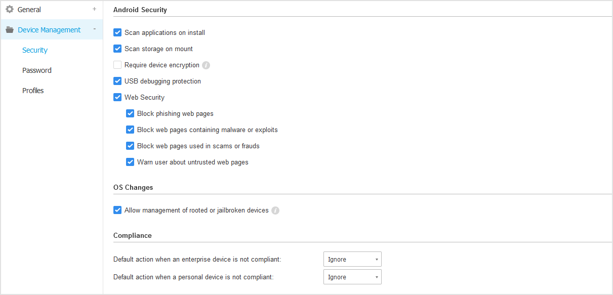

Security
In this section you can configure various security settings for mobile devices, including antimalware scans for Android devices, management of rooted or jailbroken devices or the action to be taken on non-compliant devices.
Important
The antimalware scanning is performed in the cloud, therefore the mobile devices must have Internet access.
Android security
  • Select Scan applications on install if you want to perform a scanning when new applications are installed on the managed mobile devices.
  • Select Scan storage on mount if you want to perform a scanning of each storage device when it’s mounted.
    Warning
    If malware is found, the user is prompted to remove it.
    If the user does not remove detected malware within one hour after detection, the mobile device is declared non-compliant and the selected non-compliance action is automatically applied (Ignore, Deny Access, Lock, Wipe or Unlink).

  • Android devices in USB debugging mode can be connected to a PC through a USB cable, allowing advanced control over their apps and operating system. In this case, the mobile devices' security may be at risk.
    Enabled by default, the USB debugging protection option prevents using devices in the USB debugging mode. If the user activates USB debugging, the device automatically becomes non-compliant and the non-compliance action is taken. If the non-compliance action is Ignore, the user is notified about the unsafe setting.
    Nevertheless, you can disable this option for mobile devices that require working in USB debugging mode (such as mobile devices used for developing and testing mobile apps).
  • Select Web Security to enable web security features on Android devices.
    Web Security scans in-the-cloud each accessed URL, then returns a security status to GravityZone Mobile Client. The URL security status can be: clean, fraud, malware, phishing or untrusted.
    GravityZone Mobile Client can take a specific action based on the URL security status:
    • Block phishing web pages. When the user tries to access a phishing website, GravityZone Mobile Client blocks the corresponding URL, displaying instead a warning page.
    • Block web pages containing malware or exploits. When the user tries to access a website spreading malware or web exploits, GravityZone Mobile Client blocks the corresponding URL, displaying instead a warning page.
    • Block web pages used in scams or frauds. Extends protection to other types of scams besides phishing (for example fake escrows, fake donations, social media threats and so on). When the user tries to access a fraudulent web page, GravityZone Mobile Client blocks the corresponding URL, displaying instead a warning page.
    • Warn user about untrusted web pages. When the user is accessing a website that was previously hacked for phishing purposes or recently promoted through spam or phishing emails, a warning pop-up message will be displayed, without blocking the web page.

Considered a security risk for corporate networks, rooted or jailbroken devices are automatically declared non-compliant.
  • Select Allow management of rooted or jailbroken devices if you want to manage rooted or jailbroken devices from Control Center.
    Because such devices are by default non-compliant, they are automatically applied the selected non-compliance action as soon as they are detected. Therefore, to be able to apply them the policy security settings or to run tasks on them, you must set the non-compliance action to Ignore.
  • If you clear the Allow management of rooted or jailbroken devices check box, you automatically unlink rooted or jailbroken devices from the GravityZone network. In this case, the GravityZone Mobile Client application prompts a message stating the device is rooted / jailbroken.
    The user can tap the OK button, which redirects to the registration screen. As soon as the device is unrooted / unjailbroken, or the policy is set to allow the management of rooted / jailbroken devices, it can be re-enrolled (with the same token for Android devices / with a new token for iOS devices).

You can configure specific actions to be taken automatically on devices detected as non-compliant based on device ownership (enterprise or personal).
When adding a new device in Control Center, you are prompted to specify the device ownership (enterprise or personal). This will allow GravityZone to manage personal and enterprise mobile devices separately.

Default action when the device is non-compliant
When a device is declared non-compliant, the user is prompted to fix the non-compliance issue.
The user must make the required changes within a specific time period, otherwise the selected action for non-compliant devices will be applied (Ignore, Deny access, Lock, Wipe or Unlink).
You can change the action for non-compliant devices in the policy at any time.
The new action is applied to non-compliant devices once the policy is saved.
Select from the menu corresponding to each device ownership type the action to be taken when a device is declared non-compliant:
