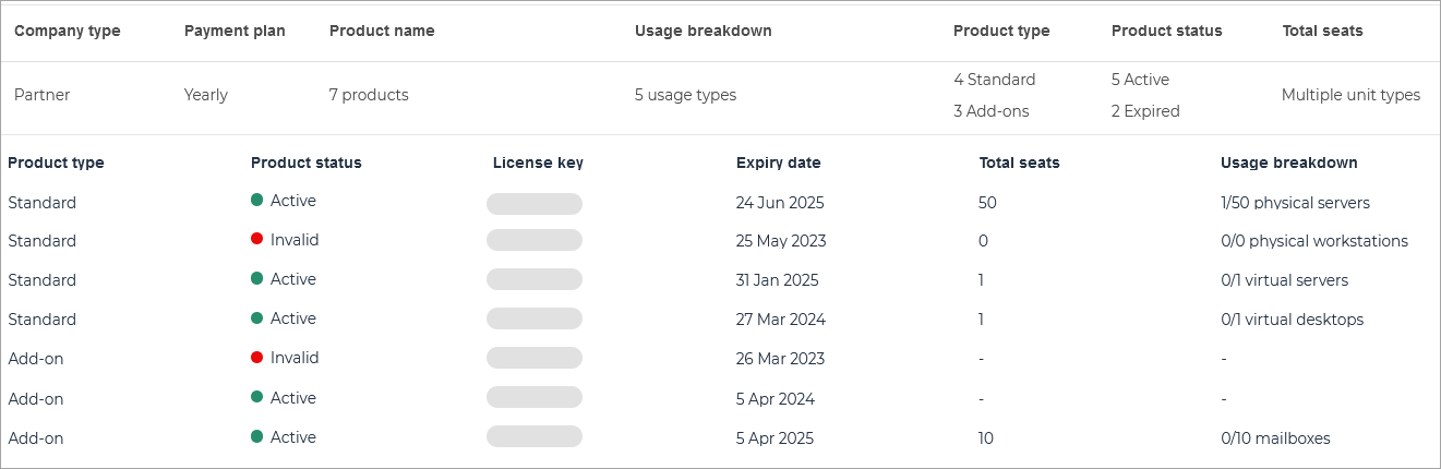

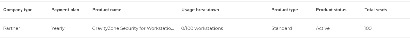

This license offers 100 seats that are only applicable for workstations. None of these seats are currently in use.

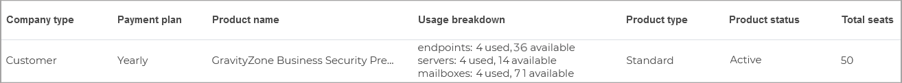

This license offers 50 seats for multiple endpoint types:
endpoints, with 4 seats in use and 36 remaining.
servers, with 4 seats in use and 14 remaining.
mailboxes, with 4 seats in use and 71 remaining.
Depending on your license, the total number of seats may apply differently to specific endpoint types. In this case, 150% of the total number of seats are available for mailboxes and 35% for servers.

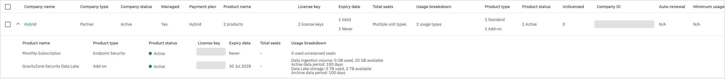

The expanded company view will offer information for each individual license.
This company has 15 seats allocated, 0 of which are currently being used.
There are a total of 30 seats available for this company. There are 3 seats available, 0 in use, and 27 are reserved for clients.
