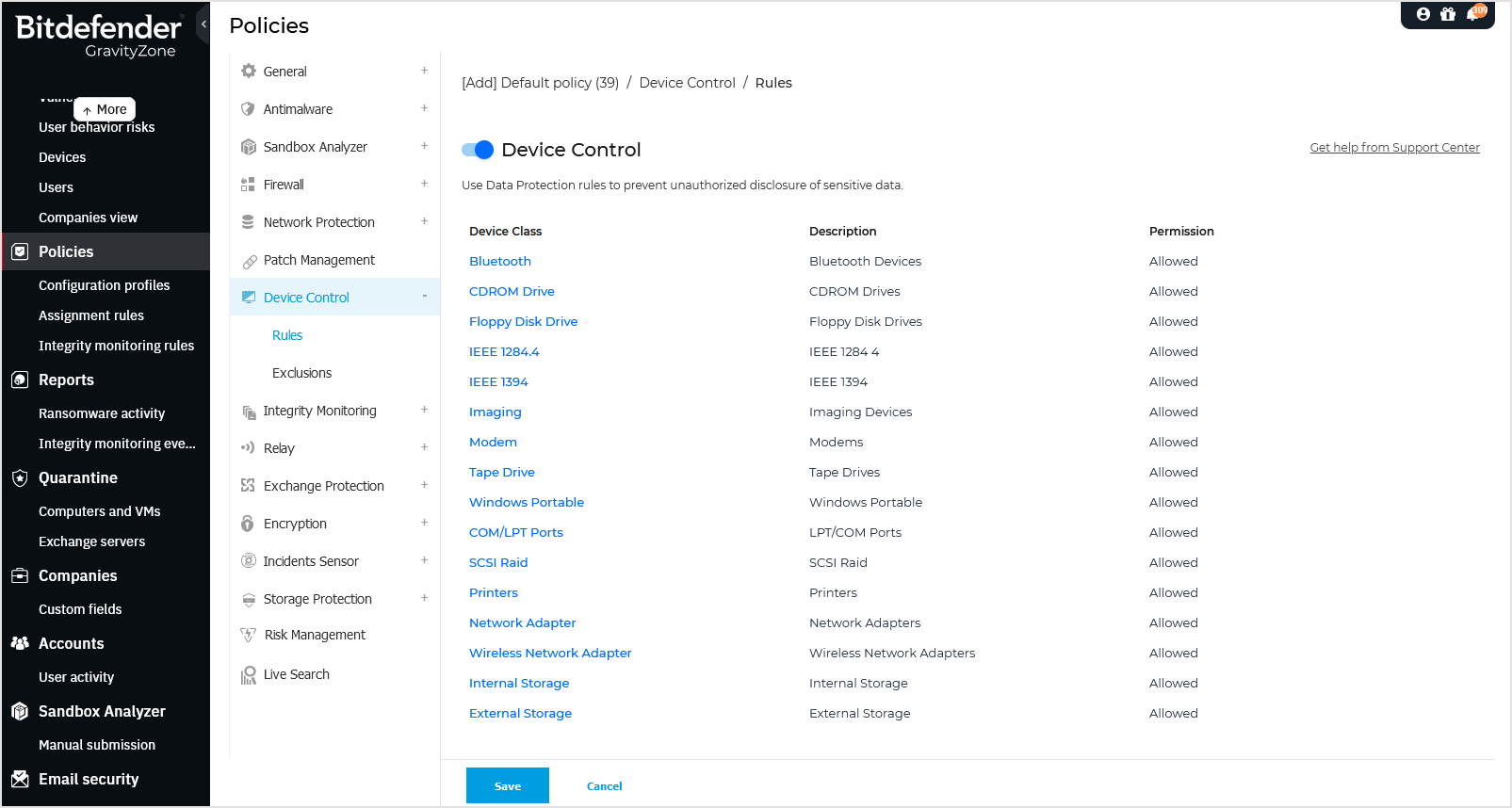

Rules
The Device Control > Rules section in the policy allows you to define the permissions for devices connected to the target endpoints.
To set permissions for the type of device that you want:
  1. Go to Device Control > Rules and click the toggle to enable a permission category for the selected device type.
    Once enabled, you must configure the access rules accordingly. Enabling the toggle alone does not apply any restrictions. You need to define what is allowed or blocked under each permission to enforce proper control.
  2. Click the device name in the available table.
  3. Select one permission type from the available options. The available set of permissions may vary according to the device type:
    • Allowed: the device can be used on the target endpoint.
    • Blocked: the device cannot be used on the target endpoint. In this case, each time the device is connected to the endpoint, the security agent will prompt a notification stating that the device has been blocked.
      Important
      Connected devices previously blocked are not automatically unblocked by changing the permission to Allowed. The user must restart the system or reconnect the device to be able to use it.
    • Read-Only: only the read functions can be used with the device.
    • Custom: define different permissions for each type of port from the same device, such as Firewire, ISA Plug & Play, PCI, PCMCIA, USB, etc. In this case, the list of components available for the selected device is displayed, and you can set the permissions that you want for each component.
      For example, for External Storage, you can block only USB, and allow all the other ports to be used.
