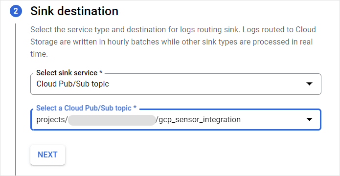

    4. In the Sink destination section, select the Cloud Pub/Sub topic service and the topic you have previously created. Click Next.
    5. Click Create sink.

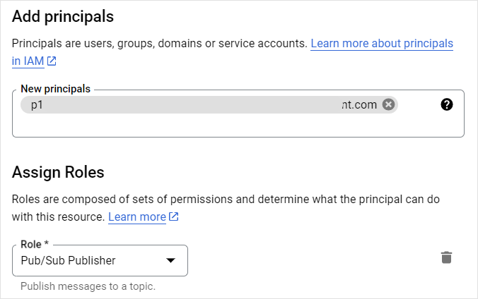

  5. Configure the Pub/Sub topic with the Pub/Sub Publisher role.

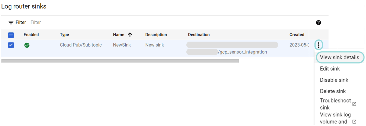

    1. Type Log router in the search bar at the top of the page, then click the corresponding Logging > Log router page result.

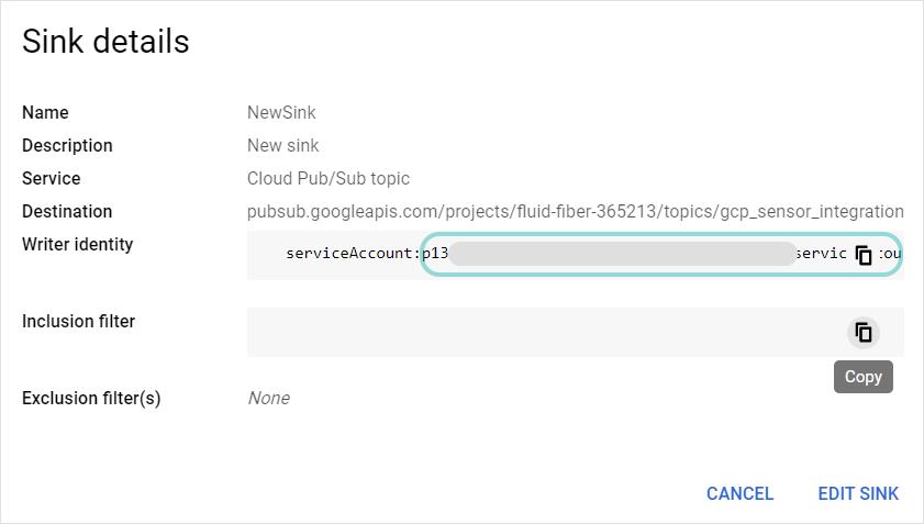

    2. In the Log router sinks dashboard, click the inline menu for your newly created sink and select View sink details.
    3. Copy the value of the Writer identity field, starting after serviceAccount:.
    4. Type Topics in the search bar at the top of the page, then click the corresponding Pub/Sub > Topics page result.

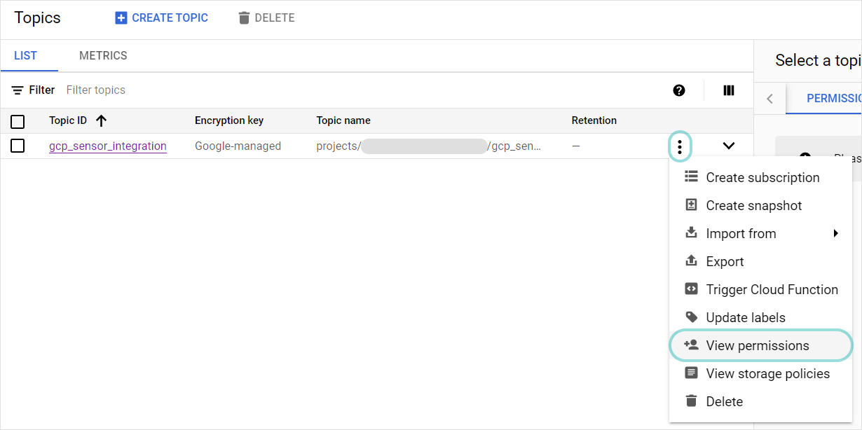

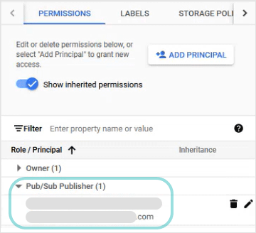

    5. In the Topics dashboard, click the inline menu for the previously created topic and select View permissions.
    6. In the right-side panel, click Add principal.
    7. In the New principals field, add the Writer identity value you have copied at step c.
    8. For the Role field, choose Pub/Sub Publisher.
    9. Click Save.

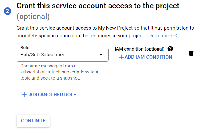

    5. In the Grant this service account access to the project section, select the Pub/Sub Subscriber role.
    6. Click Continue.

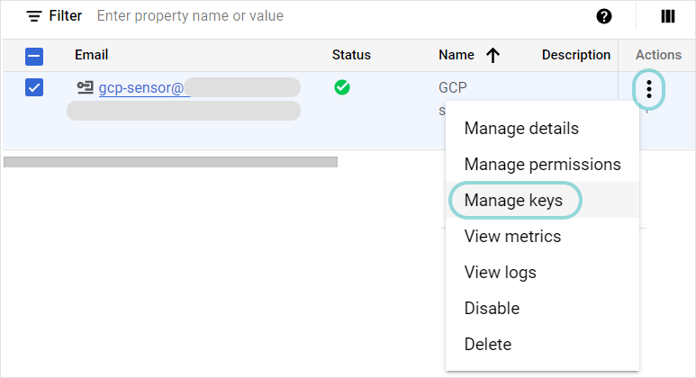

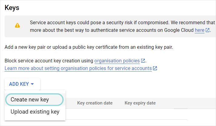

    1. In the Service accounts dashboard, click the inline menu for your service account and select Manage keys.
    2. In the Add key menu, select Create new key.

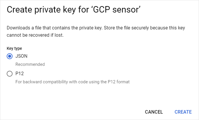

    3. Keep the default settings and click Create.
      This action downloads the JSON file required for the sensor configuration process in GravityZone Control Center.

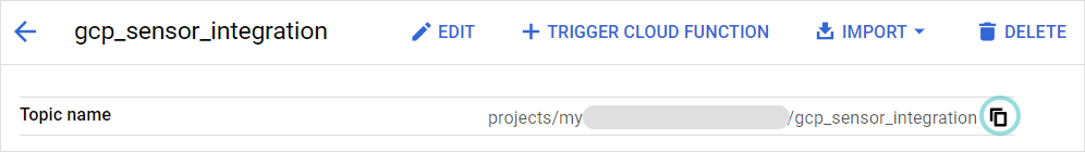

  4. At the top of the topic's details page, click the Copy to clipboard button. The full Topic name is required for the next step.

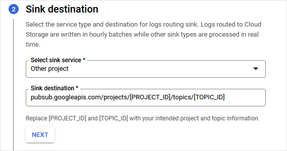

    5. In the Sink destination section, select the Cloud Pub/Sub topic service.
    6. Click inside the Select Cloud Pub/Sub topic field and select the Use a Cloud Pub/Sub topic in a project option. The field will autocomplete with a path template.
    7. In the Sink destination field, delete the all information after pubsub.googleapis.com/ and add the information you copied at step 4.
    8. Click Next.

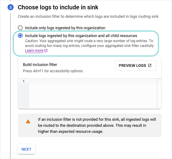

    9. In the Choose logs to include in sink section, select the Include logs ingested by this organization and all child resources option.
    10. Click Next and then Create sink.
    2. In the Log router sinks dashboard, click the inline menu for your newly created log routing sink and select View sink details.
    3. Copy the value of the Writer Identity field, starting after serviceAccount:.

    6. In the Topics dashboard, click the inline menu for the topic you created at step 2 and select View permissions.
    7. In the right-side panel, verify that the value you copied at step 6c is displayed in the Role/Principal section. If it is, move to step 7. If it is not listed there, follow the steps below.
    8. Click the Add principal button.
    9. In the New principals field, add the Writer Identity value you copied in step c.
    10. For the Role field, choose Pub/Sub Publisher.
    11. Click Save.
    6. Click Continue.

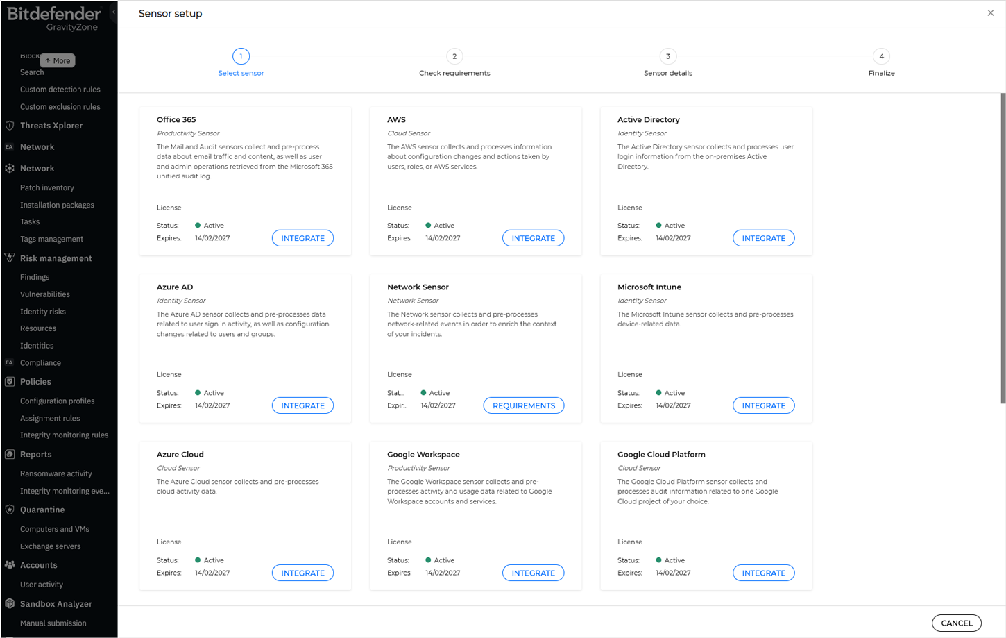

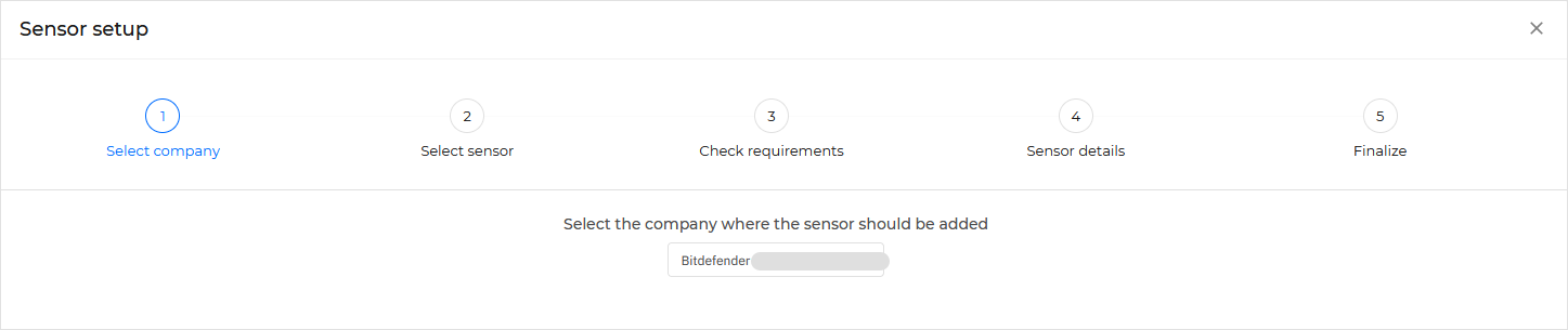

  1. In the Configuration > Sensors Management page, select Add new to integrate a new sensor.
  2. Select the company where you want to deploy the sensor.
  3. Select the Google Cloud Platform sensor and click Integrate.
