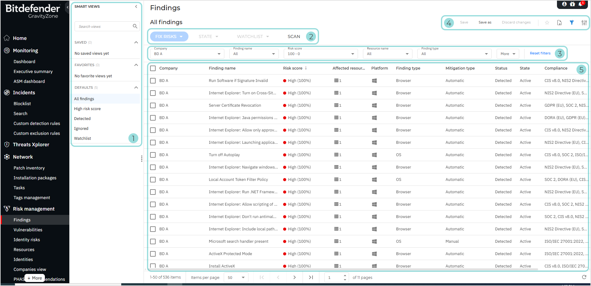

The Findings page displays by default all the GravityZone indicators of risk. It provides detailed info of their severity, number of affected resources, the finding type, mitigation type (manual or automatic), and status (active or ignored).

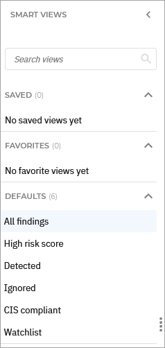

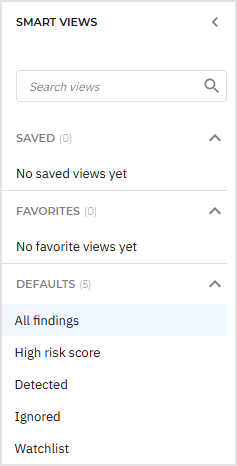

  1. The Smart views panel. This feature allows you to customize, save, and switch between different loadouts of the Findings page.
    The panel has the following sections:
    • Search views - Use this search field to filter out the views displayed in the sections below, by name.
    • Saved - This section displays a list of all your saved views that have not been marked as favorites.
    • Favorites - All views marked as favorites are displayed under this section.
    • Defaults - This section displays the views that are available by default:
      • All findings
      • High risk score
      • Detected
      • Ignored
      • Watchlist
    For any view in the Saved or Favorites category, you can click the vertical ellipses ellipses.PNG to Rename or Delete the view.
  2. The Finding actions. This section contains the buttons to all available actions you can take on the selected risks on the page:

  3. The Filters section. You can use these options to customize the risks that are displayed in the grid.

  4. The View options menu. This section provides you with multiple functions for working with views:

  5. The Findings grid. The grid displays all known findings in your company, based on your last scan.
