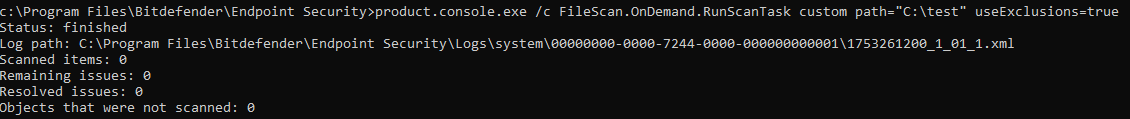

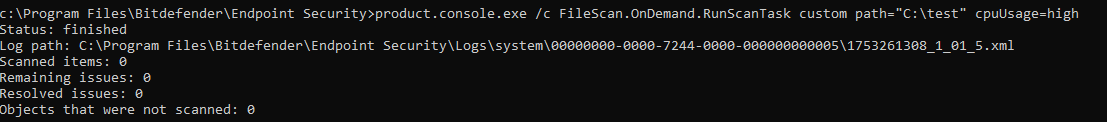

FileScan.OnDemand.RunScanTask custom [option]
Starts an on-demand scan and displays the path to the scan log and the summary of the scan.
This command requires the parameter custom
, followed, if needed, by one or more options. For example:
With options, you can customize a scanning task. These options are not mandatory.
Each option has two or more available values, but you can use only one value.
When the FileScan.OnDemand.RunScanTask
command does not specify any option, the custom scan takes into account the default value of that option.
For example, if you run this command without mentioning the scanKeyloggers
option, that means BEST still scans for keyloggers, according to the scanKeyloggers
default value (true
There are no specific commands for Quick scan or Full scan. However, you can configure FileScan.OnDemand.RunScanTask
to scan either only the OS location or the entire system, with all options enabled, as needed.

path="<path>"
Enter the path of the scan target location. For multiple paths, use: path="<path1>" path="<path2>"
Example:
FileScan.OnDemand.RunScanTask custom path="C:\Program Files"
