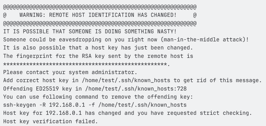

SSH
The traffic capture rules for SSH are managed either by the /opt/bitdefender-security-tools/etc/nad.d/01-ssh.sh script for the iptables traffic capture technology, or internally by Network Attack Defense for the eBPF traffic capture technology.
Network Attack Defense receives and scans traffic for both incoming and outgoing connections, for port 22 only.
If Scan SCP/SSH is enabled in GravityZone, Network Attack Defense will be able to decrypt outgoing connections and detect more potential attacks.
Warning
If PKI login is enabled without password login as a fallback, the login will fail unless the configuration outlined here is applied: Configuring authentication with SSH Keys when Network Attack Defense is enabled.
Note that certain tools, such as minikube, use SSH with PKI authentication internally.
